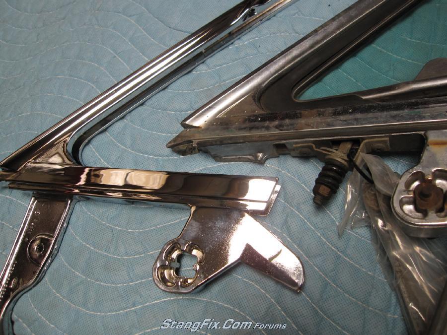

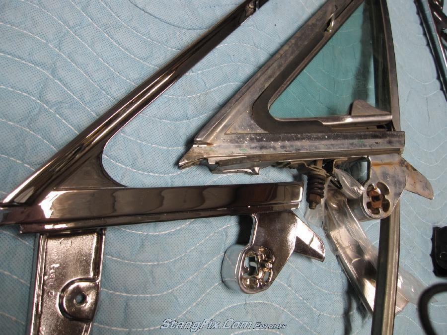

These pics do zero justice but was trying to show the before and after of having the vent window frames plated. Actually the unplated one is broken so I had to find another core to replace it.
The area of concern is the small triangle down in the lower exterior corner, with the plates polishing it gone. I made sure the plater knew to not mess this area up and they did not. This was a new plater I wanted to try for they were cheaper and the leadtime was much quicker than my trusty old plater.
Very happy with the results. Now I get to reassemble the frame and start stuffing the doors. Oh joy!!!
Yes, they did a great job. My plater almost sanded that triangle out. Were they able to remove all (if any) pits?
